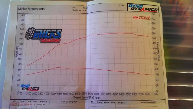

Default T2554 @ 12psi on E85
My dyno sheet after finishing the car
NB8A stock
T25
Log mani
3 "inch turbo back
Intercooler
850 cc injectors
Dw200
Haltech ps1000 ecu

Not too shabby...Nice job!

Pretty stout for that little turbo, that would probably be like 230-240 monkeypower on a dynojet
I bet it feels good

yeah feels amazing suprised how much kick it actually has when boost comes on, e85 defiantly helps with the torque increase and mid range

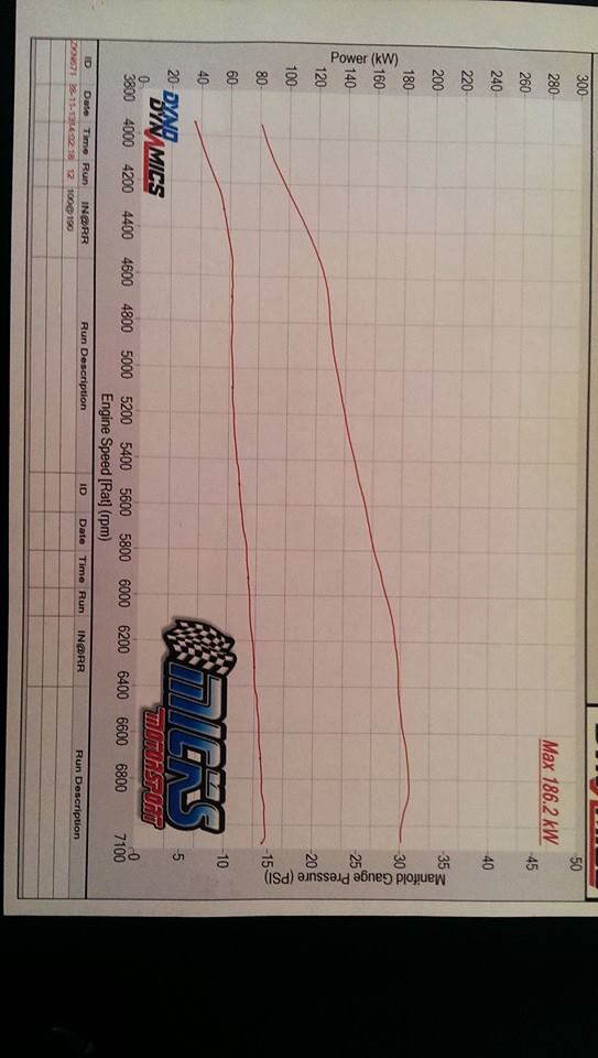

Now running a china 2870 at same boost

No doubt, you can get to MBT with it and not detonate, there is tons of power there.
What china 2870 are you using (there are dozens, and my freind has one so I am curious).
Also, that is 249 hp for you lazy folks.
