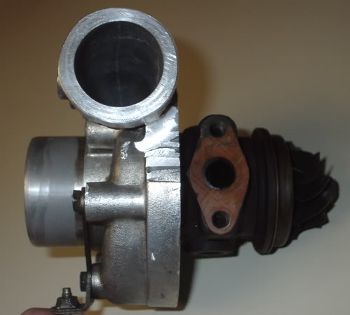

You can also grind the compressor outlet flange down to just leave the outlet round and slide a coupler over it. There are some pics on here somewhere. I just did the same to my SR20 T25 last week and it came out great. Only cost me some time with a 4" cutting disk and a hand file.

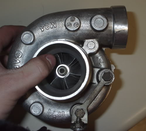

If you grind it down, be ready to make a huge mess. Make sure you don't do it inside your garage. Found a pic on my computer of someone on the board who did it.

It's not that hard. Just don't use a grinder for all of it, use a cutoff wheel for the majority of the extra metal. Quicker and makes less of a mess. The ATP parts are nice, but $50 for one flange (didn't need one for the intake) for a turbo that cost $50 just doesn't make sense. Plus, since that is what Begi does it makes it a direct plug and play to replace it with a GT2560 on down the road (a Begi or FM one anyway).
