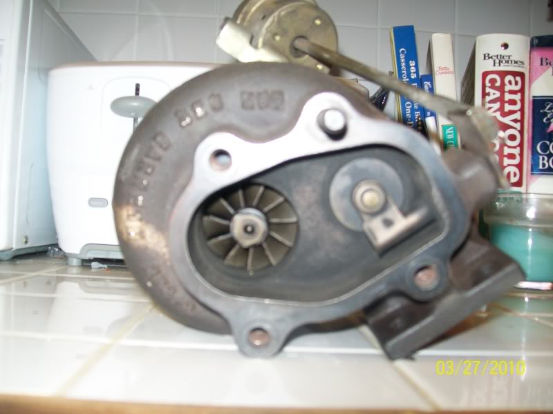

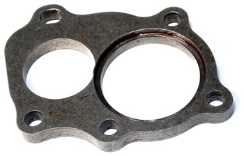

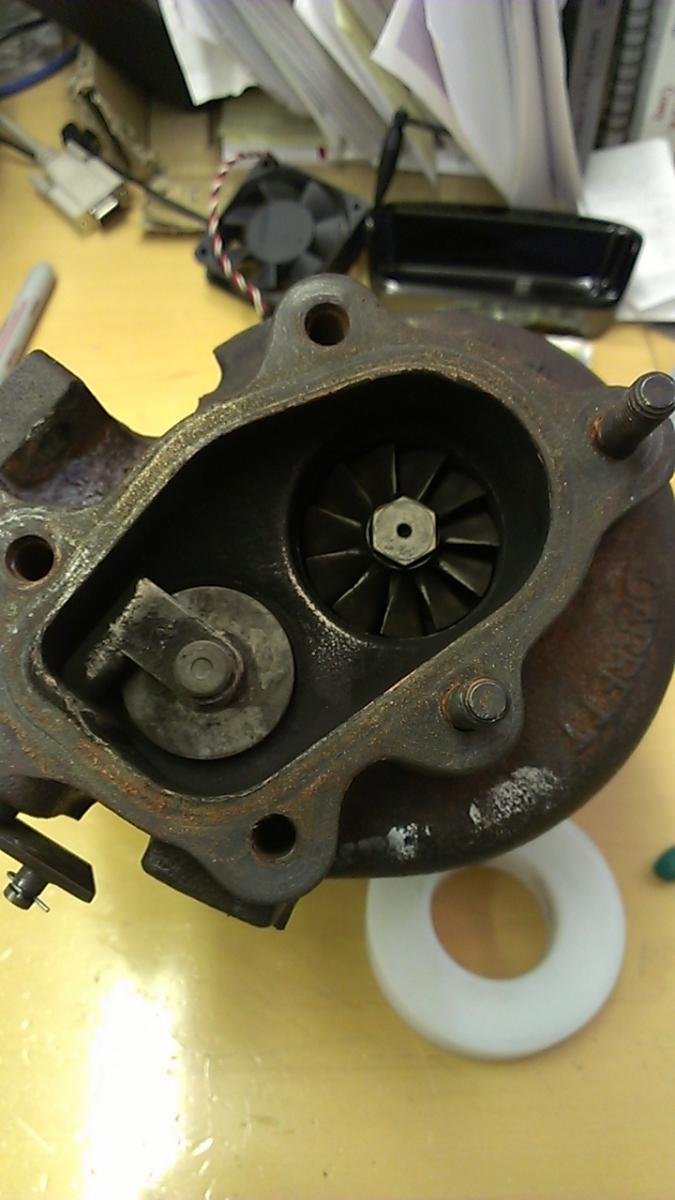

Originally Posted by andy13
what size of exhaust would yous recomend?
I have had a look at lots of T25G and either my computer is being usless or I am ( probably me) but what flange is on manifold I have seen 2 types, a circular one with 2 bolts and a square one with 4 bolts?
Everyone will tell you to run a 3" exhaust and a big *** Magnaflow muffler, but 2.5" seems to get the job done for an awful lot of people. The key is mandrel bends and smooth transitions.

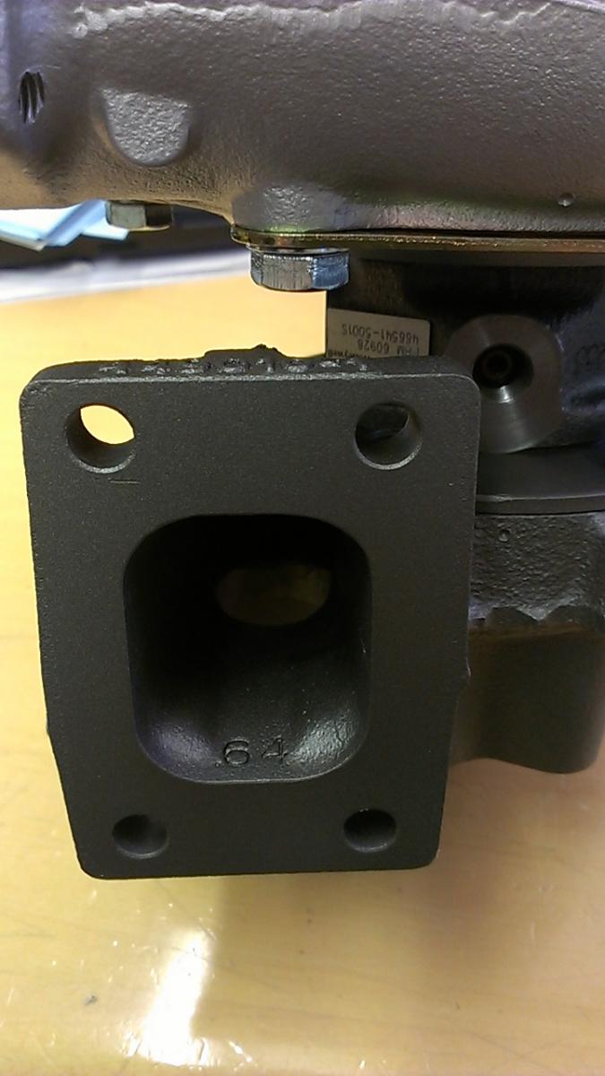

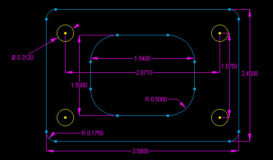

Standard T25/T28 Turbine inlet:
Standard T25/T28 Turbine outlet:
I can't say I've ever seen a "circular one with 2 bolts" but if you are seeing T25s with a 4 bolt compressor inlet and a round hole, it may be a TD05 from a DSM. Check out Joe's thread: https://www.miataturbo.net/useful-sa...flanges-52542/ for more details

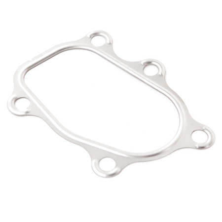

I did a full 2.5" on the last build I did before I sold the car and had great results. The typical T25 flange has 5 bolts. The 300zx T25 turbos used a 4 bolt flange. Go with the 5 bolt.
300zx t25 turbo:
