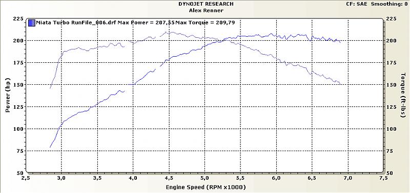

Not to take away anything from your results, but I got a very similar torque curve from a $300 used turbo (Mitsu TD04-13T from any Impreza WRX, very easy to find in ebay or subby forums). My engine is a 1.8 though, but on that run i went WOT late, it usually is fully spooled by 2800rpms in 4th gear.
This turbo is very nice for the cheap DIY´er.
Dynojet, 12 psi falling to 11 psi.
