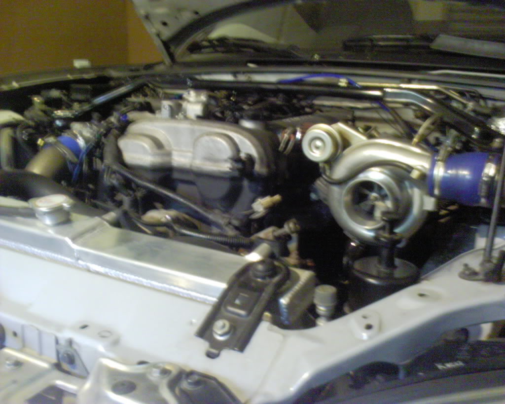

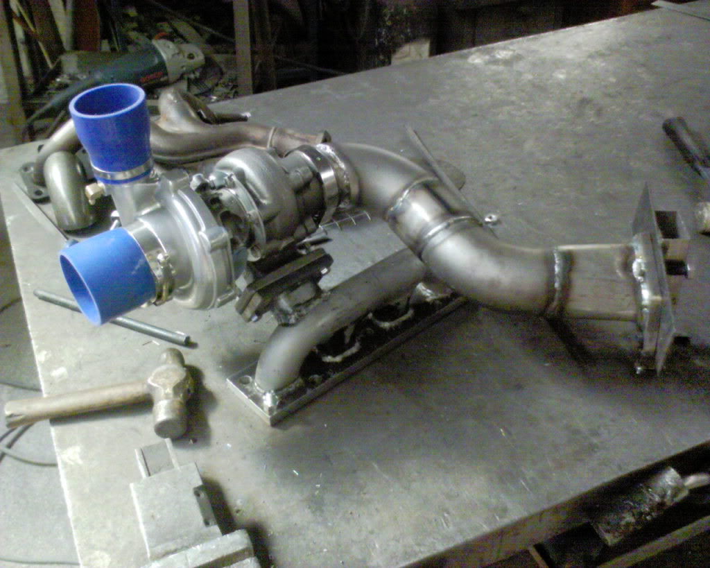

me.

Yes, it's a custom made manifold. 10k miles on it and still don't crack so I expect it will last a few years.
Spool is crap, but it's not caused by the manifold, i'm on stock exhaust (european) with restrictive cat and muffler.

160kpa@4800rpm, but i think it would be much better with a complete 3" exhaust, ebc hookep up and intake leaks fixed
The turbo is a 60 trim .48 cold .63 hot with internal wastegate.
