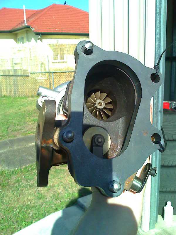

any idea which TD04 this is?
Old Oct 23, 2010 | 02:30 AM
a wrx one.

rectangle triangle all the same stuff
You will probably have to get a WRX flange and have it welded to whatever manifold you get...I dont know of one being produced.
Check with some of the fab guys from here, see if anyone wants to make you a custom manifold.
