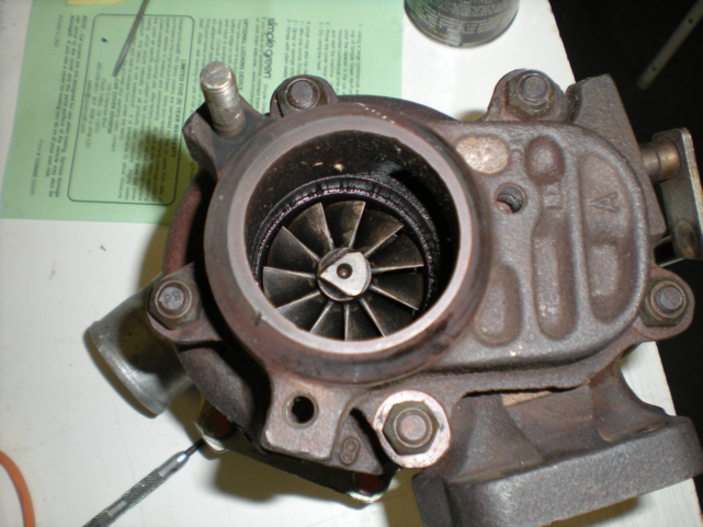

I have a T3 turbo that supposedly came from a Volvo 740 Turbo (it matches the sample I found online). Where can I find a downpipe flaired piece to match the flaired flange exit on the turbo? The ID of the flair is about 50mm and the OD is about 70mm. I tried the local yards but they seem to have the 740 Turbo downpipe confused with that yellow precious metal.

why not just pick up a flat-flanged turbine outlet and not use the flared one? I might have an extra, PM me if interested. Post pics of it as well.

I have a flared flange.

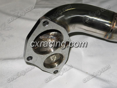

Zoomin, here is a pic of the turbo outlet and the downpipe I plan on modifying to fit (it's made for a Mitsu 16G/T25 but I got it cheap). The BOV is actually in the 5 bolt adapter plate shown in the pic.
PM sent.

Hi, I have the same wastegate!
IIRC I bought this T3 Turbo 3 bolt Downpipe Exhaust Manifold Weld Flange and then I milled down the flared part of the wastegate. Then from there you can build your own downpipe
double check the bolt distance in that link above with your wastegate!

nuvolarossa, I found a flanged downpipe from a member. If that falls through, I'll look into doing what you did.

Thanks to zoomin, I now have a flared flange. If I cut a piece of exhast tubing to fit, can a muffler shop put a flare on it?

wow, that arrived quick. they should be able to flare it for you.
Old Jan 12, 2009 | 09:22 AM
Posts: 80,588
Get the flange machined flat...
