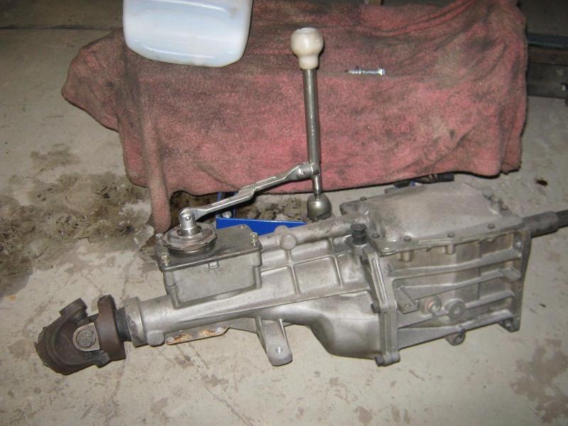

Another idea for linkage
Going into a local Cobra build (I have nothing to do with it), and it is supposed to work well enough (for a Cobra)

that shifter linkage is sexy
wonder what it does for gate width

Fortunately, the shifter relocation is a tick more elegant than the bent wrench Cobra link. Easier, too.
