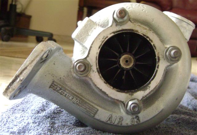

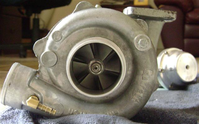

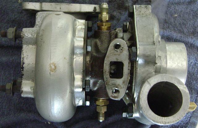

Rob, I found these pics:
Attached Thumbnails T3 .48 turbine housing in good shape-turbo-turbine-small-.jpg   T3 .48 turbine housing in good shape-turbo-iii-small-.jpg   T3 .48 turbine housing in good shape-turbo-ii-small-.jpg
Old May 29, 2008 | 07:48 PM
Posts: 80,564
Total Cats: 4,369
what does that outlet measure? doesn't look stage I.
stage I has a 60mm inducer and 42.5mm exducer....something like that
that's also a t04e compressor wheel....that turbo looks like fun....
I'll see if I can measure tomorrow. I'm not complaining about the turbo at all. I just find it spools a little late on the RPM band with a stock engine.

That turbine looks bigger than a stage1. There are several four bolt SPA t3 48AR turbine housings on eBay - all stage1. You need to measure first, then shop.
IMO swapping to a .48AR isn't going to make the difference you're looking for- based on what (I think) you want. It might move your powerband back a few hundred rpm.
