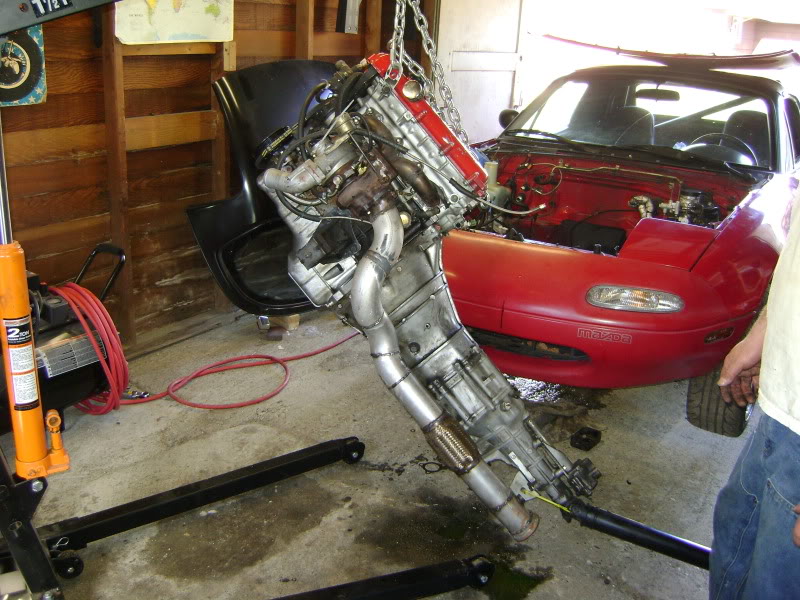

If you can wait til after the 5th of june i'll sell you my manifold, turbo and downpipe for 700 bucks. SR20 T25 with a SS bottom mount manifold and 3" bellmouthed downpipe.
