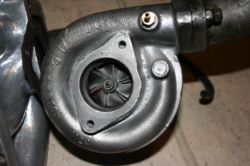

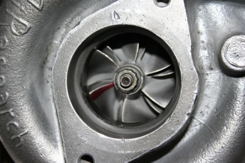

My mistake. I don't know the trim.
Here are some pics of it:

measure the size of that inducer.

.60/.48 tells me two things only: it has a .60 A/r compressor housing and it has a .48 A/R turbine housing.
The turbine, since a factory unit, is more than likely the standard Stage-I wheel, so with teh .48 A/R housing it's a good size for a 1.6L; what I use.
As far as the compressor wheel is concerned, I have no clue what size it could be without doing the research for you. I'm sure I could type in google "Ford T-bird T3 turbo" find out everything you want to know and then copy in paste it over here, but instead I decided to use that time to write this reply instead.
My guess is going to be a 60 trim wheel capable of around 250-300rwhp or so.

Compressor *looks* like a 60 trim as the small ones didn't usually use the ford .60 housing.
A .48 stage I turbine is a good turbine for 250whp and below. It won't really do much more than that unless you get a better blade in that housing. Great inexpensive street turbo IMHO.
