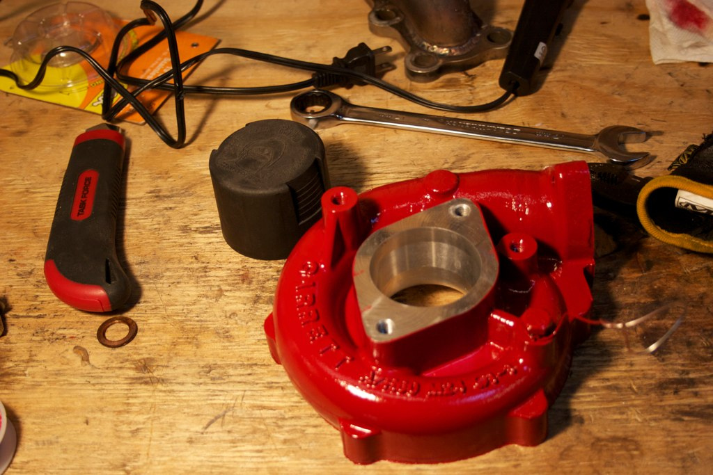

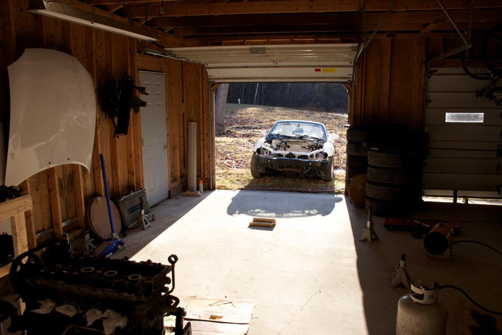

Here's a couple quick shots of my project so far. Nothing too interesting, really, I just felt bad for not having any pictures in any of my threads for a while.
Attached Thumbnails The thread where Skidude asks stupid questions-6916934623_1727402c6c_b.jpg   The thread where Skidude asks stupid questions-6916932131_878f4de2dc_b.jpg
