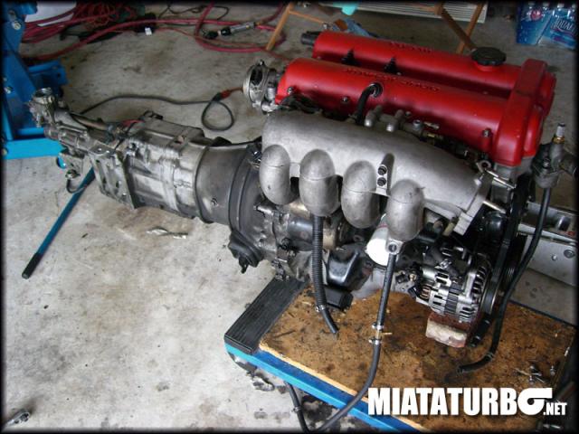

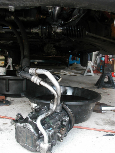

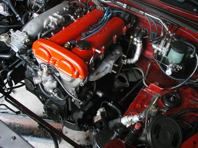

Posts: 80,564
Total Cats: 4,369
Attached Thumbnails The thread where Skidude asks stupid questions-img_5106-_medium_.jpg   The thread where Skidude asks stupid questions-enginepull011.jpg   The thread where Skidude asks stupid questions-enginepull013.jpg

And as usual, Brainy shows everyone else up :(.
That's actually a neat way to do it Brainy.

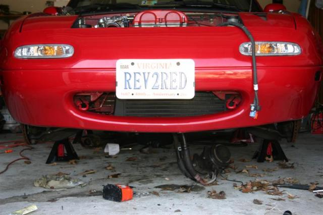

Old Jan 27, 2012 | 10:49 AM
Posts: 80,564
Total Cats: 4,369
spal are worth the cost. These china fans lack the CFMs.
fuel will still spill, but not keep pouring. I simply unplug at the hardlines, and typically take a spare hose and loop the two.
I dont think you'll ahve issue with your returnless...just make sure the hardline isn't the lowest point between the filler.
Attached Thumbnails The thread where Skidude asks stupid questions-enginebuild006.jpg
