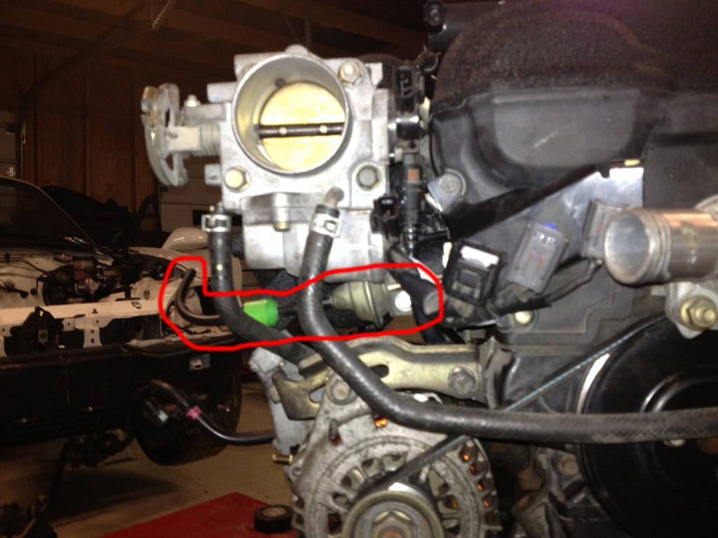

So nobody can help me with the VTCS solenoid? I took pictures of that area of my engine bay before I disassembled everything, but none of the pictures show which solenoid that hose went to. It's all obscured by other stuff. I suspect it's the orange sensor I have, but I honestly don't know.
Old Mar 16, 2012 | 04:48 PM
  #43
skidude's Avatar
Posts: 2,023
Total Cats: 19
From: Outside Portland Maine
This is the hose that runs to the actuator, if anybody could take a picture of the solenoid, or describe it to me or something.

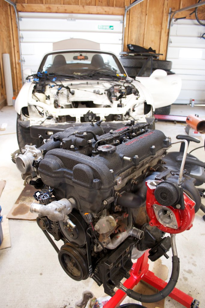

Here is how my garage looks right now. I reserved an engine lift tomorrow to put the motor back in the car.

Well, for anybody still paying attention, I put the engine back in on Saturday, and hooked it up enough to start it on Sunday. Is there a trick I missed to putting the engine in? It took me and a friend more than an hour to get the motor mount bolts lined up with the holes. Granted, we didn't have a load leveler for the engine lift, it still felt a lot harder than I expected.
The engine looked really nice in the bay, all clean and painted, and then I put all the harnesses back and plugged them in, so it looks like a rat's nest again, but a slightly cleaner and more painted rat's nest. If I were more patient, I would do a wire tuck, but I am not, so it will have to do.

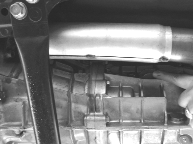

Driver's side. Fill and drain are both on the driver's side. Do not touch the passenger side bolt that looks like a drain!
Some cheap vinyl tubing from Lowes Home Racing + a funnel will allow you to run the hose down past the brake master and stuff it into the hole. 1/2" ID tubing will fit almost exactly, and seal well enough that when the fluid gets to that level it will start backing into the tubing, making checking for when it's full very easy. That way if you spill something, you spill it in the engine bay.

It's the "Magic bolt of transmission rebuilding". I can't find my pdf of the manual for the 6 speed, the M.net link in the garage doesn't work unless you buy premium access to hypershares, and the boostedmiata link doesn't work either. But it holds stuff in place internally, and if removed, the transmission has to be taken apart to get the stuff back in the right position.
The fill bolt is the higher (duh) bolt forward towards the bellhousing.
Image shamelessly stolen from the interwebs. Link to m.net article here.
