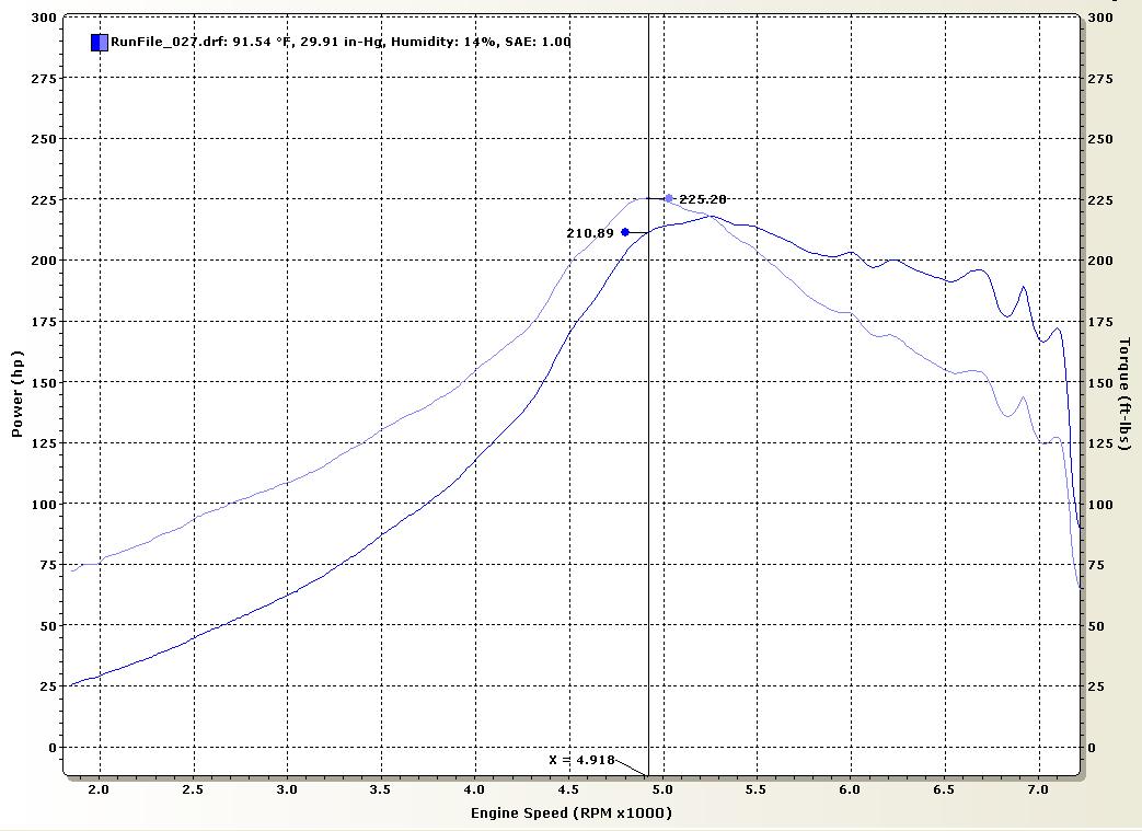

T3 60 trim, dyno 2 at 22 psi
Old Jun 17, 2012 | 12:11 PM
Techsalvager's Avatar
Joined: Jun 2009
Posts: 1,866
From: albany, ga
Default T3 60 trim, dyno 2 at 22 psi
22psi
Old Jun 17, 2012 | 12:15 PM
22psi and 225whp? seriously?

I made those numbers with like 14psi on a 2554. Something is way off with your setup.

well let me know what it maybe I'll be more then happy to fix it
at 22psi it was dropping out of boost down to 16 psi up top

Dude. I was so excited to see that someone else was running man boost.
But then I saw the world's saddest dyno chart.
Your boost taper is prolly due to VE fail.
Still though. Even with 16psi you should be at well over 200hp.

I think around 12 psi it was at 180 whp at higher rpm, I'll have to check again

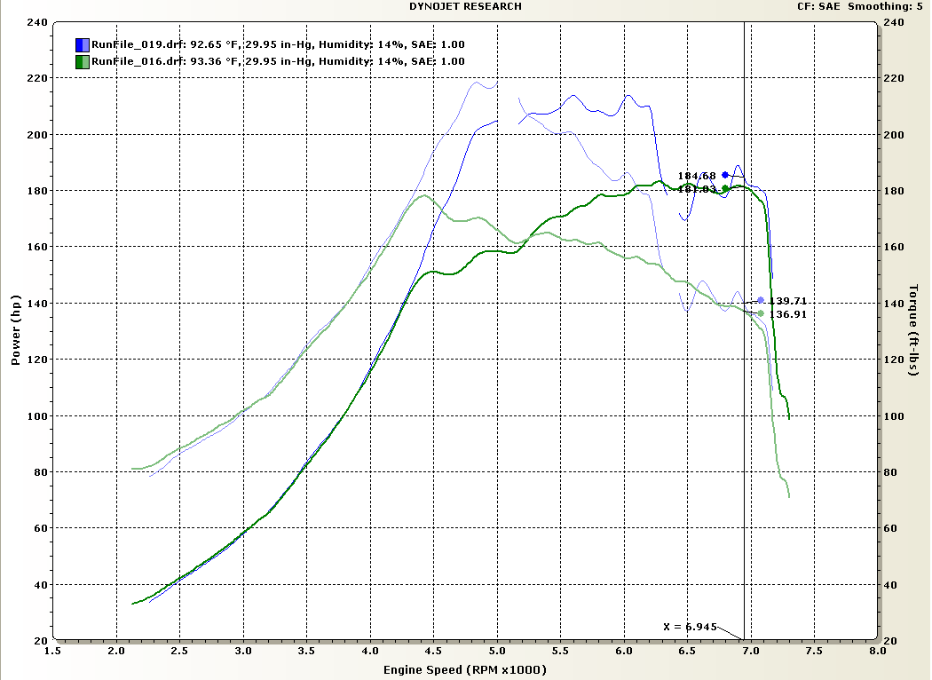

Here is a comparsion of 20psi taper to 16 with some knock at the end of the run vs 12psi hold

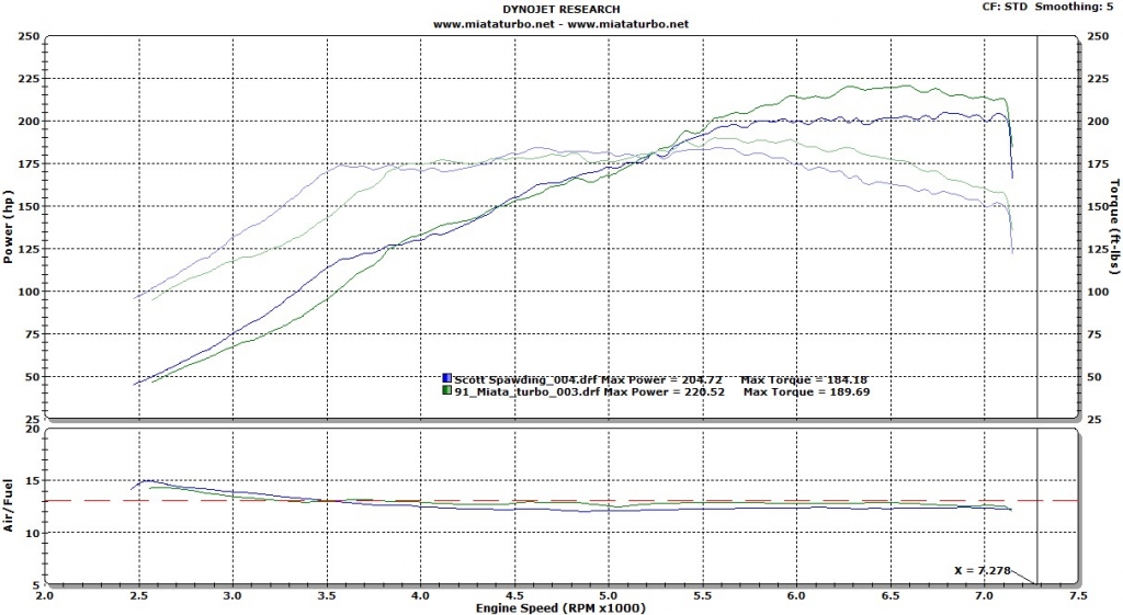

this was mine at 13psi:
why are you choking up so much up top? that turbine flows much better than a gt28 and the compressor is good for ~300rwhp

I"m not sure, I"m gonna retry later and remove the exhaust and just run the downpipe down and see if it holds boost out to the end of the revs

or perhaps you don't realize that load effects the turbo output.
the pulls posted were 3rd gear pulls due to slipping clutch in 4th gear.
But you can see it pushed power production farther back, really nothing to be susprised about.
Also since I went testing on my car, I puilled the exhaust off and left the downpipe on it.
I went from 80% duty cycle to 95% duty cycle. Still same boost drop out issue.
Next plan is to make a dual port wastegate using the current wastegate.
