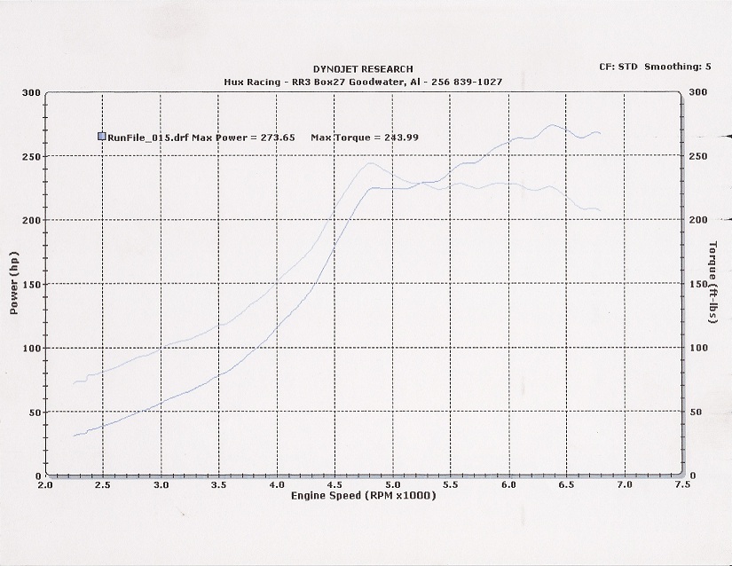

FYI, just for comparison... My 60 trim T3 at 20psi, 430cc injectors at 95% duty, 1.6L... I'm going back to a 50 trim for the street car.

genesplicer is that 1:1 gear and can you change it to repersent speed vs time instead in the graph?

1:1 yes, 3.9R&P, I'd have to get my tuner to re-save it with speed vs time for you. I'll try giving him a shout tomorrow.

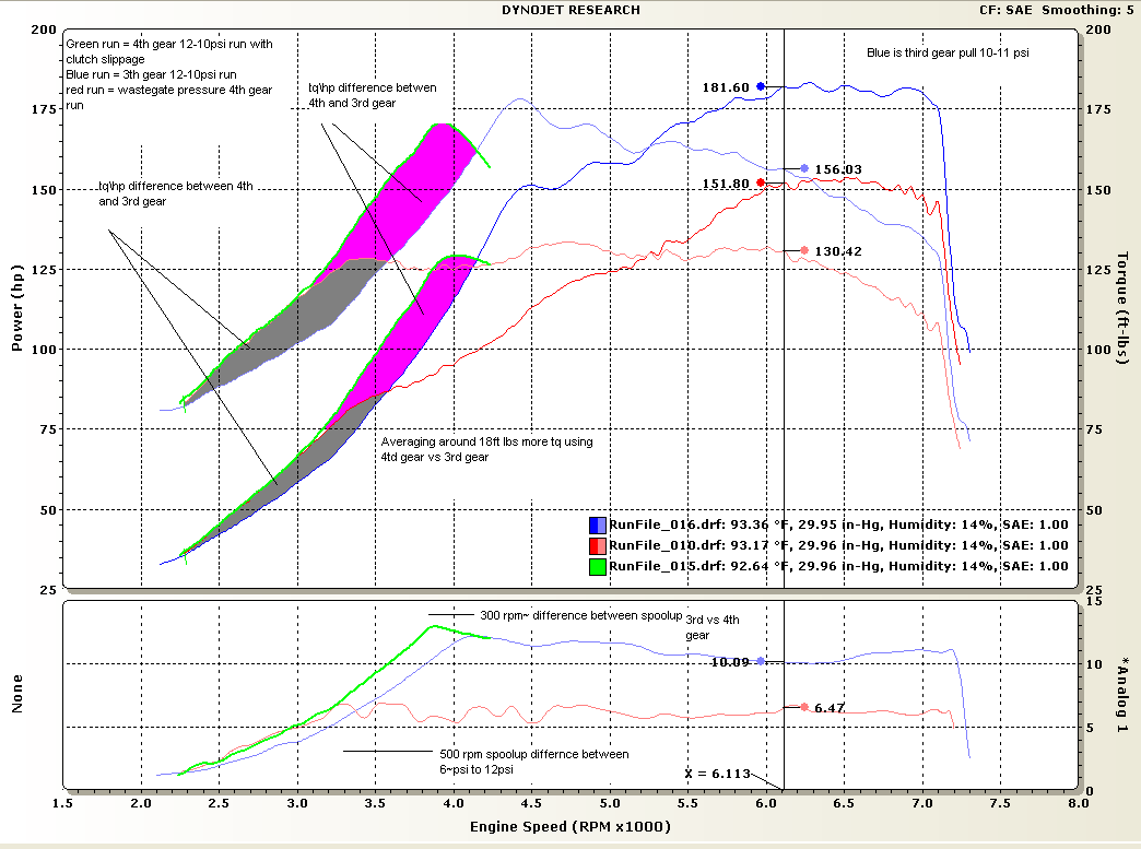

Here is two images
one is 3rd vs 4th gear on the dyno
the other is a comparsion between wastegate pressure on old cam timing and setup vs advanced 5 degrees and new setup.
4th gear are the ones that start sooner, it drops off because of clutch slipping.
3rd is the one that starts later.
stock cam timing is blue
advanced is red
green is trying to add more igintion timing at where the power drops out, but I think that issue is intake design.
