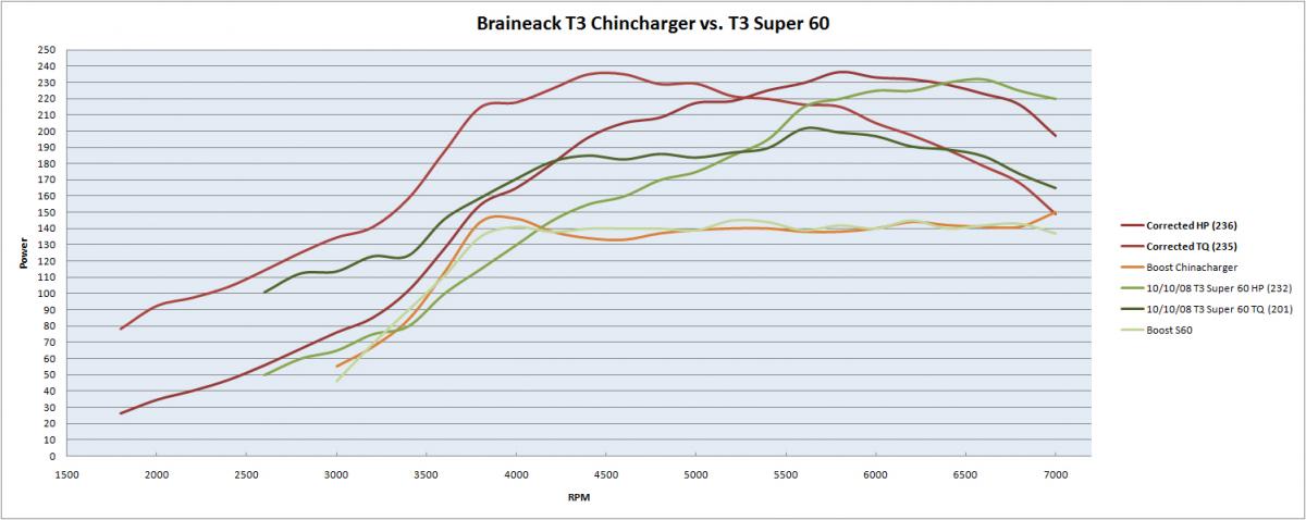

yeah I'm on 460cc injectors and hitting 90% DC at around 240rwhp.
that compressor wheel is good for 27 lb/min and the turbine shouldn't choke up like that...there's gotta be something choking it or something. Even my smaller 50 trim T3 is outputting better up top:

ive dyoned my car maybe 20 times now on a dynojet; ive done it in 3rd and 4th and had the exact same output each time. youre pushing a concrete cylinder and the software determines the gear ratio. the output wont change.
when on a loaded dyno, if you don't set it up right it WILL screw up the output. I've seen this when the operator used 4th instead of 5th on a 6-sp.
anyways, look at the above plot comparing my chinacharger and my t3 super 60 again...
And I can still take it out on the streets and show you that gearing still effects power output, you will not make the same tq at 4000 rpms in 2nd gear that you make in 4th gear. I've done my own dynoing with my AQ-1, just watch the accelerometers, they will tell you the dirty secerts of the car. A turbo requires load to get it making power.
I've seen the plot, its cool expect for when it goes from nothing to hell broke lose. around 3700 rpms
